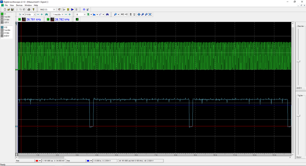

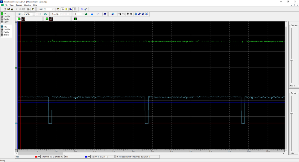

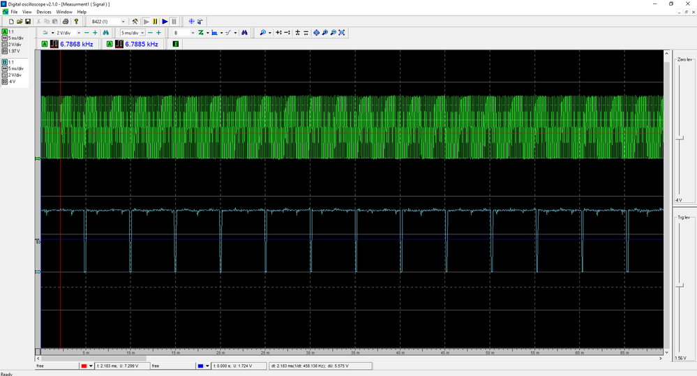

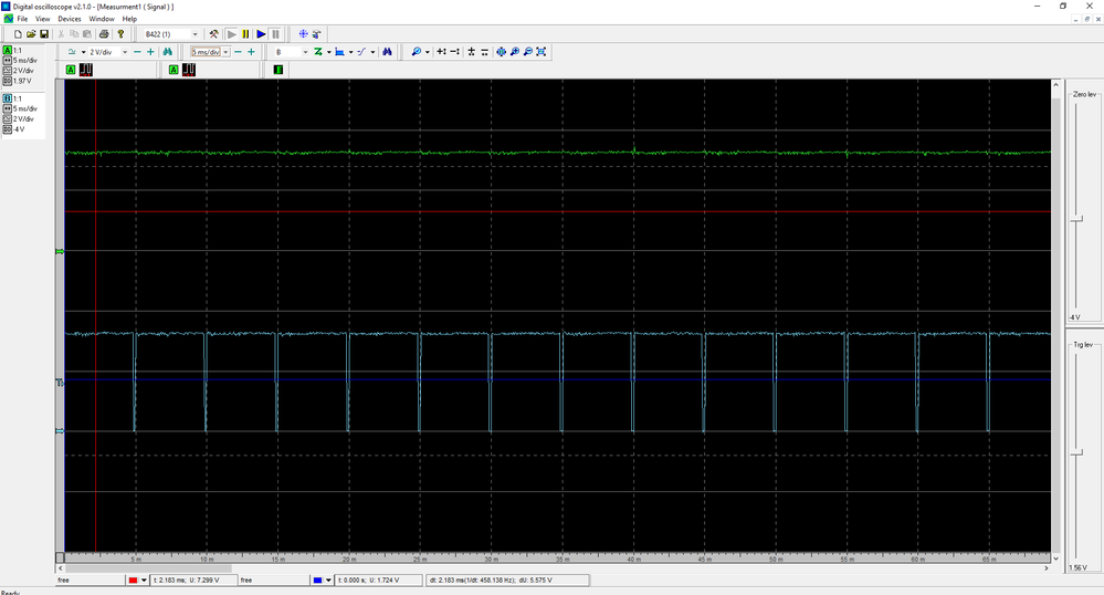

Hi @Eleon BORLINI!
Yes, in this pictures source of green signal is the INT1 pad and source of blue signal is the INT2 pad.
There are two different groups of snapshots: first two snapshots was catched with scope attenuator 1:1 and last two pictures was catched with scope attenuator 1:10.
BugOperation:
NormalOperation:
BugOperation1_10:
NormalOperation1_10:
2021-03-12 3:18 AM
@Eleon BORLINI
We tested this situation without INT2 pad, it was enabled but physically removed from steval board J1 header, because we was thinking that this is the crosstalk interference, but it didn't helps. So, now we need to move forward and we make desicion to count ODR with timestamp feature.
One more time:
Normal operation is when we activate fifo_th bit on any INT1 or INT2 pad and then retrieve data
Bug operation is when we use two INT pads for example like in this snapshots on INT2 pad we route fifo_th bit 1 and on INT1 pad we route drdy_xl bit 1.
Note 1: when we switch pads nothing changes, bug doesn't dissapear.
Note 2: we have two iis3dwb sensors, the error is repeated on two devices.
I hope i was understandable to describe our problem, please let me know if you will need some additional information.
Regards.
