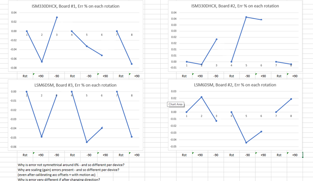

The attached graphic summarizes the types and differing amounts of error in each board. All error values are averages of 7 separate runs. Each graph has one point for each of these 5 steps in the test:
1) Reset board, Rotate 90 degrees (Right), acquire MotionFX yaw angle measurement
2) then, Change Direction ("cd"), rotate -90 degrees (Left), acquire MotionFX yaw angle measurement
3) Reset board, Rotate -90 degrees (Left), acquire MotionFX yaw angle measurement
4) then, Change Direction ("cd"), rotate 90 degrees (Right), acquire MotionFX yaw angle measurement
5) Reset board, Rotate 90 degrees (Right), acquire MotionFX yaw angle measurement. This verifies repeatability of step 1).
Ideally, all lines in these graphs should be flat (0 degrees error no matter which rotation is made or if directions are reversed).
Detailed test data and summary are in this Excel Spreadsheet, this includes for each board details about data/fusion rates, output data rate, full-scale range, etc.
Please let me know what are some additional factors that can be causing this.
(a) Is it possible that the zero-rate offset calibration performed by MotionFX is not working correctly?
(b) Why should we see different error amounts for rotations occurring initially after reset, vs, rotations occurring after changing direction?
Thank you for any expertise you can provide to help us solve these issues.
