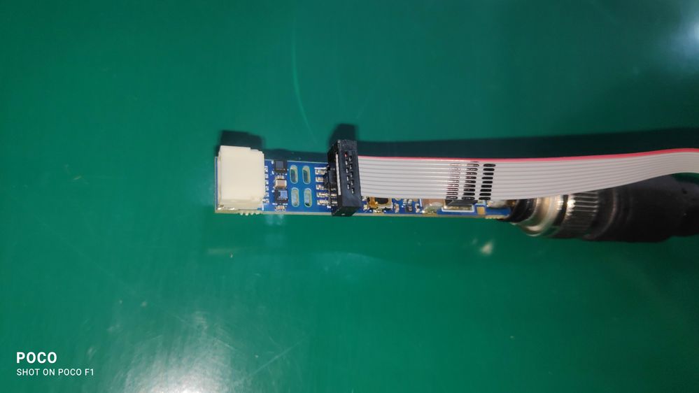

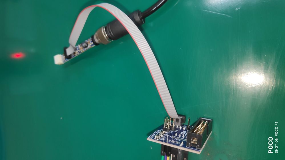

2025-05-06 12:00 AM
Yes, i am using the SWD Connector.
Yes, i applied the input voltage is 18.5 V. (brown Positive and blue negative)
Please refer the Picture.
2025-05-06 12:08 AM
I don’t recall the exact orientation of the connector on the st board but you can try connecting the swd connector on stm32 in the reverse direction (I had similar issue and I figured out that the connector needs to be connected in reverse direction and then it worked)
Also the baud rate is mentioned in the manual make sure to set that

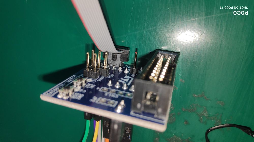

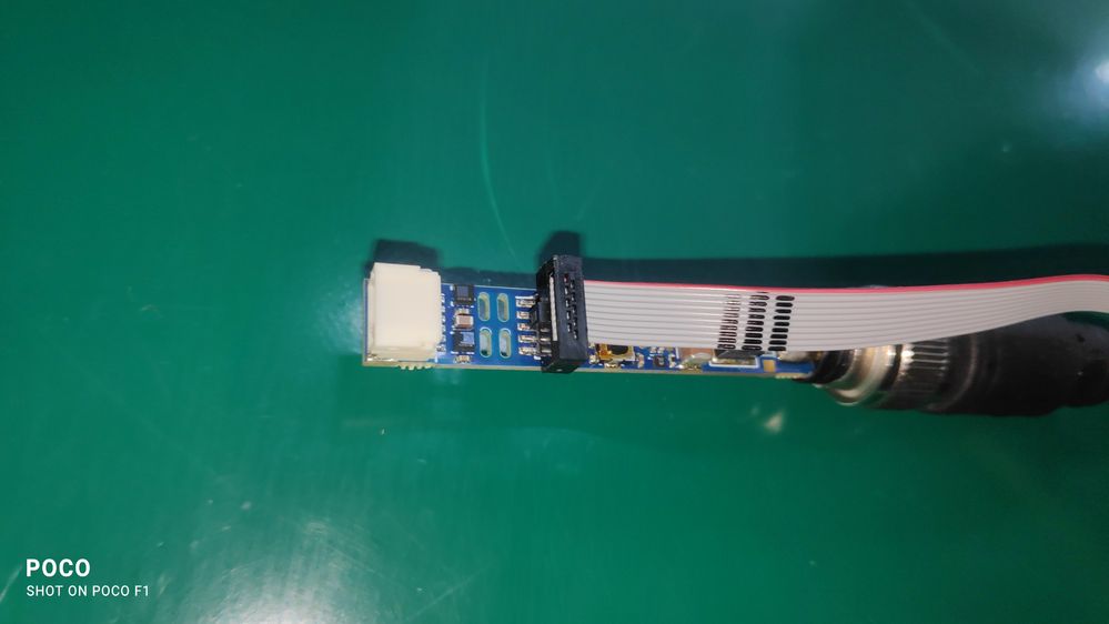

2025-05-06 1:35 AM
2025-05-06 1:38 AM
If you have any Documentation, please share to me.
i attached the clear photo.

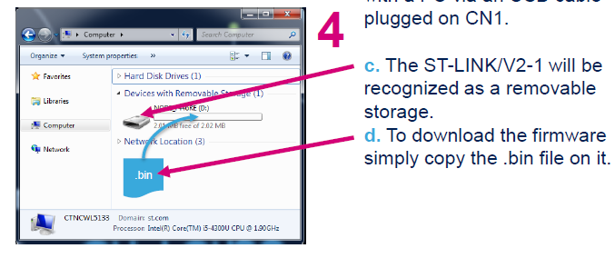

2025-05-06 1:48 AM
This 4 Step can not able to do . i am not getting the .bin files .
2025-05-06 5:43 AM
Can you tell me if you can use Stm32Cubeprogrammer software and connect to the device?
The binary file can either be compiled and generated or it is available in the BSP example folder
2025-05-06 5:48 AM - edited 2025-05-06 5:50 AM
when everything is connected as it should the led on the board (third image) should light up
if it doesn’t the steval board isn’t powered by 18v (The cable I received was faulty/ not wired correctly this might be another reason)
Check on the steval board VDD /GND is reading 18v using a multimeter to confirm its not a bad cable
