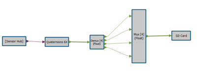

2024-01-12 1:46 AM
Hi @Federica Bossi I am using algo builder to generate the bin file.

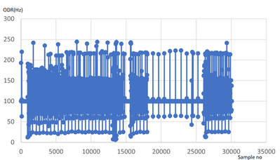

Hi @Miroslav BATEK ,
I have added data log for your reference. That data stored into the SD card with 100 Hz rate. Sample data also not logged in 100Hz. Thank you
2024-01-18 12:40 AM
Hello @DavidThomas,
I have analyzed your data and did a few trials. The drift in yaw (heading) can be solved by increasing the ATime knob. You can increase it significantly up to couple of hundreds. Increasing this will reduce the weight on the accelerometer measurements.
I'm aware about timing inconsistency when logging to SD card, we are working on that but it will take use some time to fix it.
