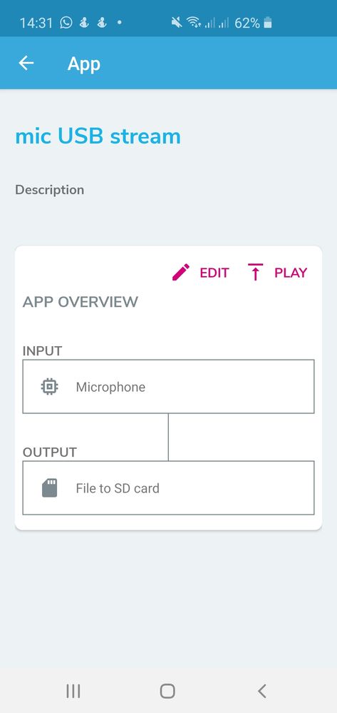

Hi @MSrik.1 , did you set up an Expert mode application with the microphone as Input? I suggest you to acquire the only microphone (without other sensors) and to save it on SD card, not sending it via BLE. This way, you will get a .wav file that can be analyzed on your PC. Regards

Hi Mardi, try to simplify your app as shown below, run the acquisition for some seconds and then check the SD card (the PC recognize the mskbox1v1 as a mass storage device when it is not connected to the bluetooth).
Regards
