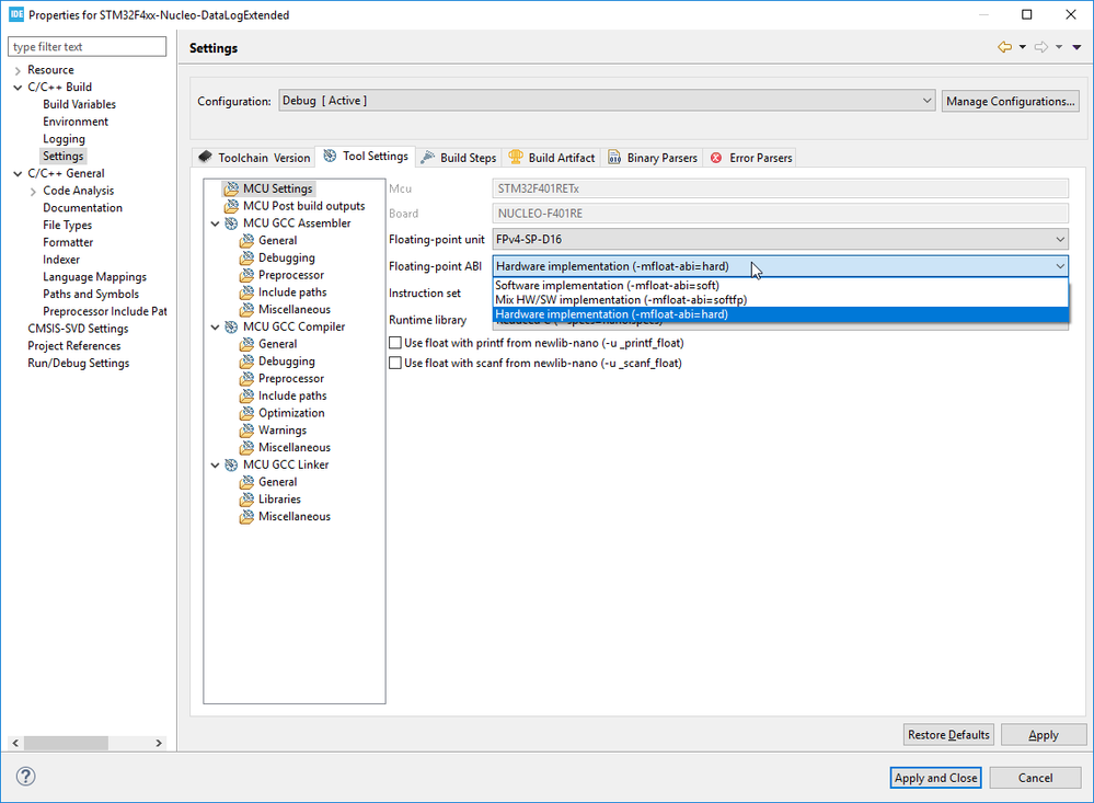

Go to project properties and try to find the settings there,
I don't have Attolic TrueStudio but in STM32CubeIDE it looks like in the attached screenshot.

Trying something: Under Properties=>C/C++ Build=>Settings=>Tool Settings=>C Compiler=>Target=>Floating point change from "Hardware Implementation" to "Mix HW/SW implementation". Also did the same under Linker (Under Properties=>C/C++ Build=>Settings=>Tool Settings=>C Linker=>Target=>Floating point change from "Hardware Implementation" to "Mix HW/SW implementation"). Now the project compiles! But I am not sure if the code is working as expected yet.
