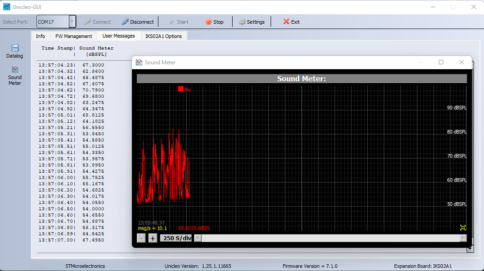

If I select SMR_PREFILTER_NONE, as default, the noise values I get in the Unicleo GUI
make sense and are around 50 to 60 dBSPL as you can see from the capture below.

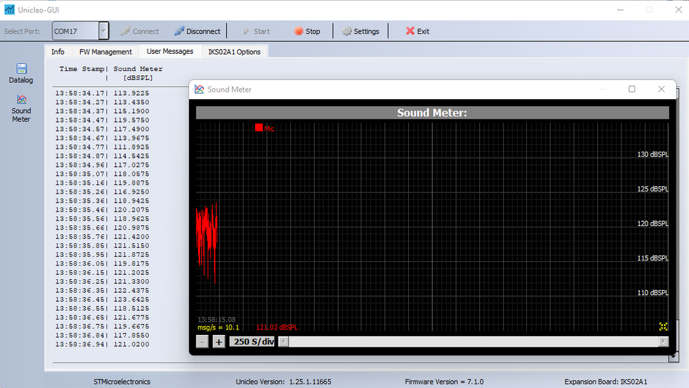

If I select SMR_PREFILTER_AWEIGHTING, the noise values I get in the Unicleo GUI
go around 115-120 dBSPL as you can see from the capture below.
These values are wrong and shold be still around the 50 to 60 dB range, as my class two sound meter
with A weighting is measuring as well.
What may be happening when the A_WEIGHTING is configured? Does the sound meter library
work properly in any configuration or just when SMR_PREFILTER_NONE is selected ?

I did what you suggested but I still get the same results, the example works with SMR_PREFILTER_NONE but if I use any of the other filtering types ( SMR_PREFILTER_AWEIGHTING or SMR_PREFILTER_CWEIGHTING ) the sound pressure level values still make no sense and are very high, around 115/120 dBSPL.
The Issue must be related to the smr_library when some filtering is requested I suppose.
