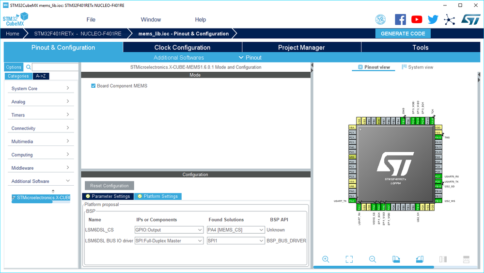

Also, when configuring the sensor on CubeMX it asks me for the Bus to control the MEMS Sensor, it doesn't set up the WriteReg and ReadReg functions with this information?
Kind regards.

Solved, reading the examples and using the BSP support was enough to get it working.

I will when i have some free time, all i did was configure properly the BSP of the MEMS component.
