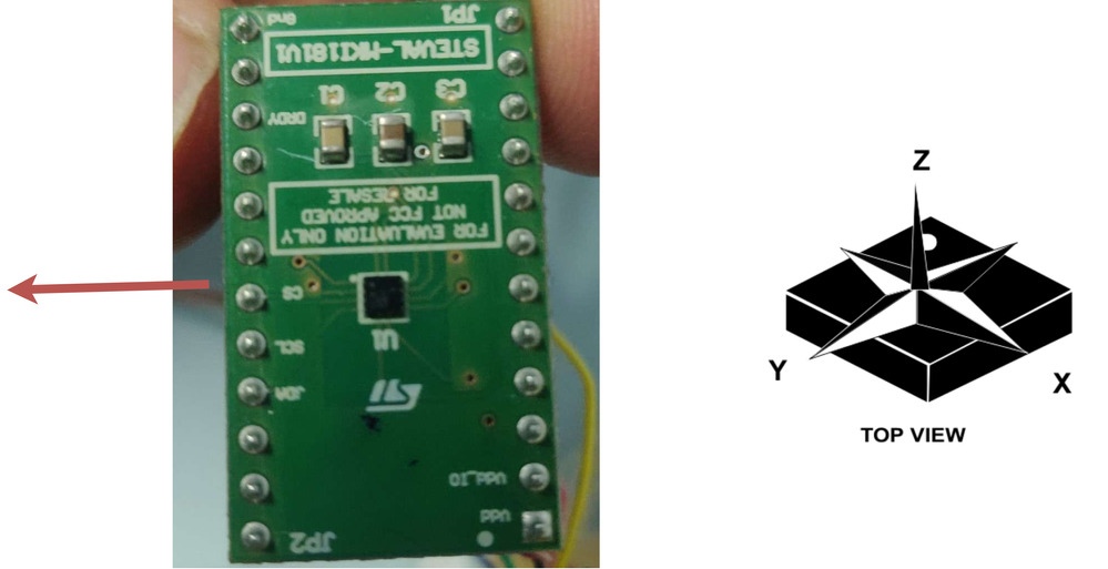

In one of our projects we have to use the accelerometer LSM6DSL, and magnetometer LIS2MDL. The tilt-compensated magnetic heading have to be computed in accordance with the values read from these sensors. We have the respective EVKs connected to our microcontroller for trying out and verifying this.
Basically, I am using the below equation for calculating the heading value,
heading = (atan2(y,x) * 180)/3.1415;And with this, I am getting the heading value properly in a way such that the North is in the direction as marked in red arrow in the below figure.

1) the axes direction labeled in the Datasheet is to the -ve direction or not?

1) I'm not sure what you're asking.
2) I'd recommend Magnetometer Calibration using MotionMC Middleware Library. You can use MagnetometerCalibration sample application in X-CUBE-MEMS1 package as a reference. Or you can even use combination of our MotionEC and MotionMC Middleware Libraries.
