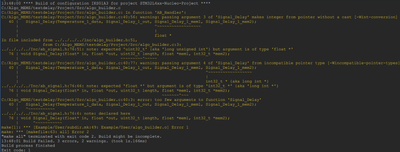

I made an example code to show temperature values from a nucleo-L476RG and x-nucleo-IKS01A3 setup.
The code should show the actual value and a delayed one:
But it gives the following error:
This exact situation was replicated on AlgoBuilder software and worked without any issue.
Any idea how could I work this out?

Hello @aesteban
indeed it is issue in the Signal Delay function block. We will fix it in the next version of MEMS Studio.
For now you can apply attached patch. Just replace the signal.json file in you MEMS Studio installation folder (c:\Users\USERNAME\AppData\Local\STMicroelectronics\MEMS Studio\release\Library\) by the one in attachment.
