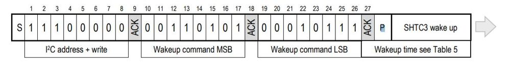

I understand what you're saying, I saw it. However, in the folowing picture I don't know what to put in the place of parameter P which is the data to bewritten into the wakeup register
2021-08-31 12:37 AM
P is the I2C stop condition. There are only 3 transaction bytes in the screenshot you posted. After the stop condition, you must wait the SHTC3 wake up time per the table before sending the next command (measurement).
