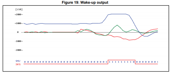

HI @MKS​ , please consider p. 75 of AN3393 for the wake-up FSM description. The threshold value (THRS1_1 (57h) = 55h in the example case, meaning FS/2^8 * 85 = 664mg), is the comparison value that generates an interrupt if the sensor data out exceeds that value and the masks are properly set to detect a particular axis or the overall acceleration resultant. I don't know if I catch your question. Regards
