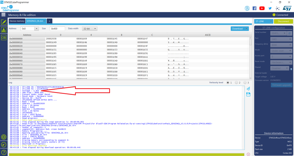

I have STLINK-V3set, and from some example i have found. I think i have managed to flash the FP-AI-SENSING1 to the SensorTile.Box, but how do i write programs for example i want to delete a certain feature in it or edit some feature in it and then upload it to the SensorTile.Box, how do i do it?

Hi @reokyouma , if you want to modify the FP-AI-SENSING1 package, you have to open it with a programming toolchain, such as STM32CubeIDE (based on Atollic) or IAR-EWARM, make your modification and then download on the SensoTile.box STM32 via STLINK-V3. However, please note that STLINK-V3set is 3.3V compatible and, as pointed out in the SensorTile.box user manual:
Note: Your ST-LINK must have the level shifter to function at 1.8 V (the SensorTile.box power supply)
This means that it is not so straightforward to debug your update FW on the SensorTile, and you could maybe generate the binary file of your app and upload it via dfu mode (boot0 button). Regards

I thought based on the log of flashing of sensing1, that the STlink have output of 1.8V
Sorry that i forgot to say that i also have MB1440B attached in STLINK-V3SET for flashing
