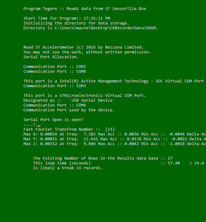

I have the tilebox pro exporting on the USB and picking it up with a new C# program.   See below.
It is reading at 18 cycles per second, I need to adjust the freq output, I thought I had a higher rate.
it is really easy to use, but I have the Android Program setting 75 from pressure and temp and 480 for acceleration and getting 18 time steps per second.  Is this your board's limitation on exporting via the USB cable.

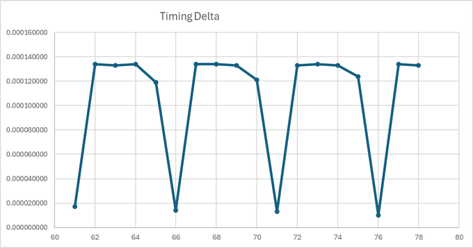

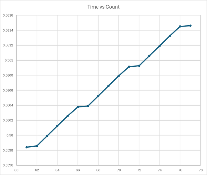

Looking at the time signal from a run this morning of 19.1 seconds.   You have steps that are not a standard distance apart, this is your algorithm adjusting for the varying measurement rates.  A sample output is shown.
If I look at the differential timing, you can see the pattern and it is not what one expects, nor is it explained in your manuals.  This is the timing steps.

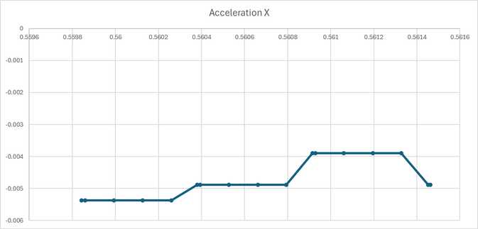

If I look at the acceleration output,  your method has introduced a pseudo flat step and triangular step into the time signal, this will show up in any post FFT analysis of this data.   And it will play with the numerical integration, so beloved of engineers.  You fill up the gyro time steps with the last acceleration data and create a flattish spot. See example.  Like determining volumes from contour data, one has to make a decision, I understand this decision, I think it would be easy to improve.
