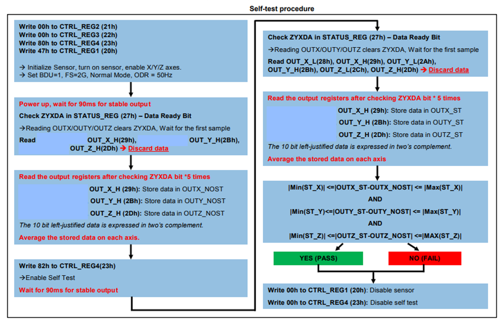

​Did you already set the CTRL_REG1 (20h) Xen, Yen and Zen bits, the LPen and an ODR different from the default?
About self test procedure, you should follow this procedure

​hi sshankar, if you followed the ds indications, everything should work...0690X000008AIcDQAW.png
