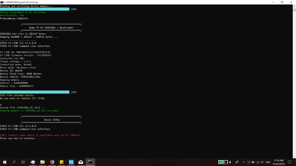

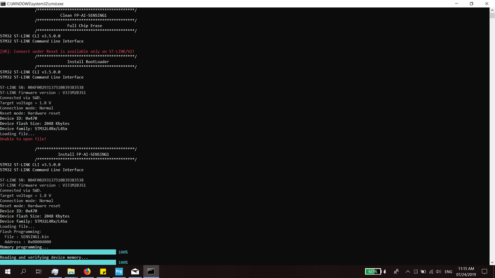

resolve connect under reset is available only on ST-Link/V2 for STLINK-V3SET
RafaelJoseph
Associate II
0690X000009Z2FUQA0.pngHow do i make the connect under reset for the STLink-V3SET?

Hi @RafaelJoseph​ , please note that the user manual of the SensorTIle.box reports the following note:
>> Note: Your ST-LINK must have the level shifter to function at 1.8 V (the SensorTile.box power supply).
This means that the device, which is working at 1.8V, can be programmed by through ST-Link/V2 and not directly though STLINK-V3SET. An adapter for the compatibility is required, and will be soon released online. Btw, you could upload your FW on the SensorTile.box via dfu mode (boot0 button). Regards
