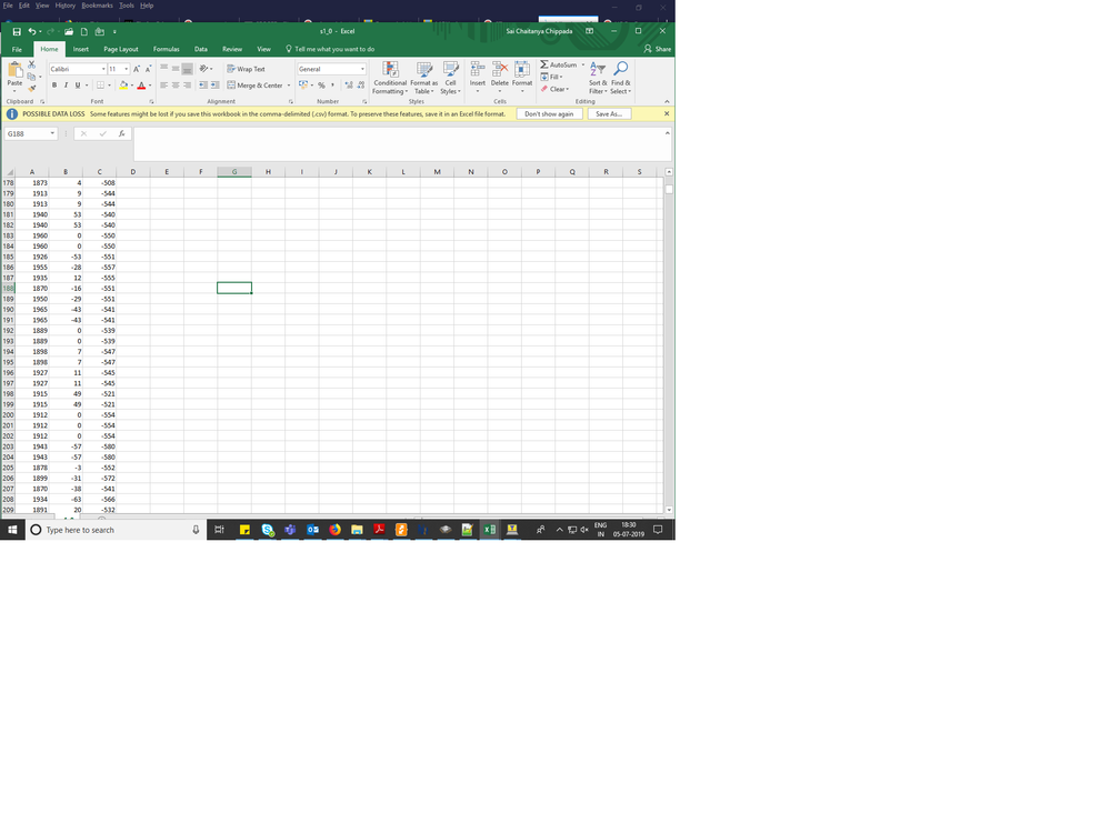

I interfaced LIS3DSH with Nordic controller(PCA10040). I am facing following issues:
  1. Data is repeating in Y-Axis.
  2. Data is coming 0 for 3 times continously in I2C read buffer.
  3. In X-axis same data is coming for 4 seconds data like 1964
please suggest any ways to solve this problems.

Hi @chaitanya chippada​ , a few questions to understand the issue: are you correctly converting raw data into 16-bit two's complement data? Are you reading data in continuous mode and at which ODR? Vdd and VddIO have the same value? Regards

Eleon BORLINI
Do you have the same issue also at lower ODR? Regards
