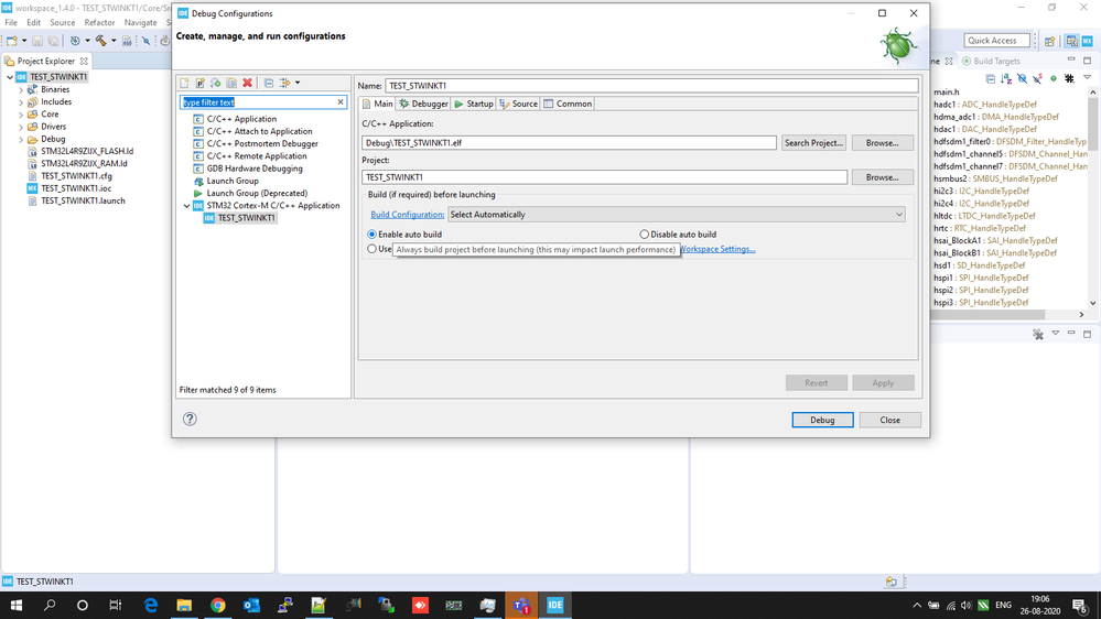

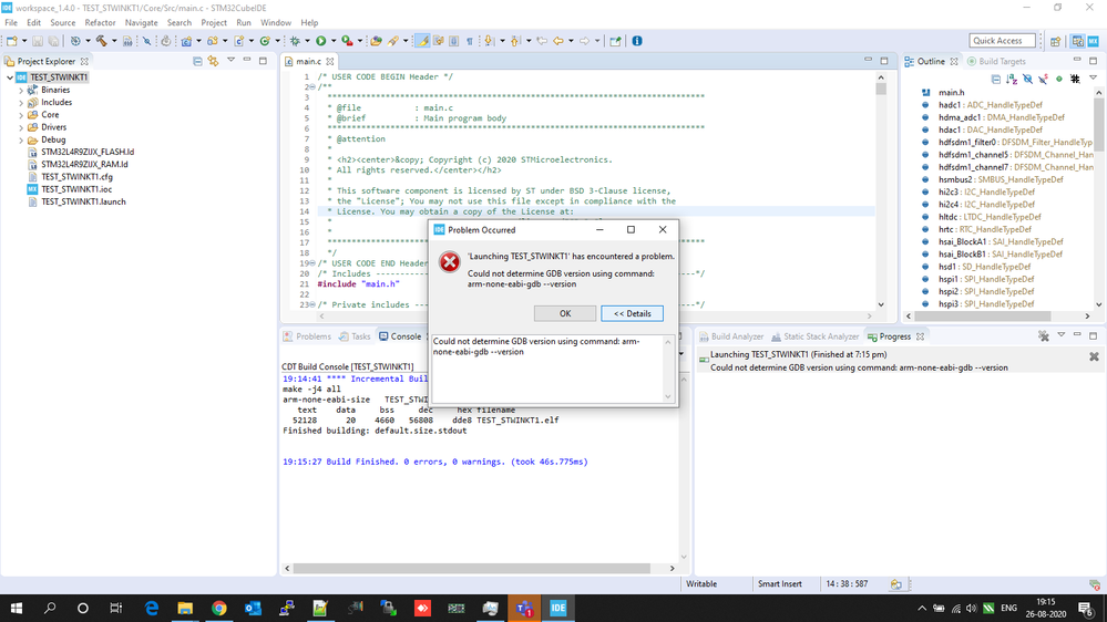

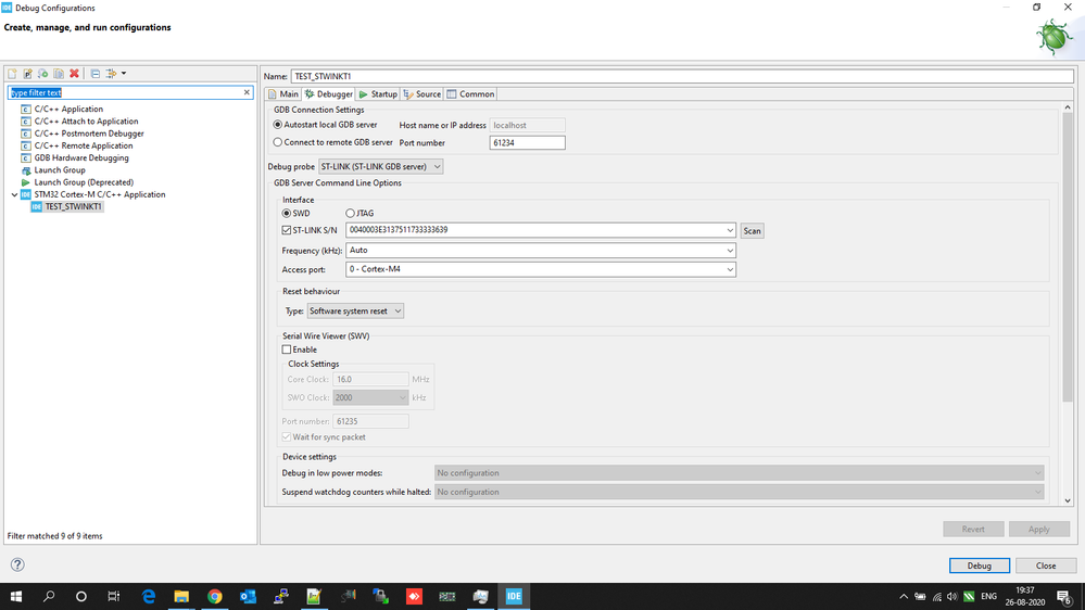

I am previously using STM32CubeIde version 1.3.0 and i am able to programme the STWINKT1 development board successfully. while i am debugging suddenly my laptop crashed and when i power on it again now i am getting error.So i uninstall version and download new version 1.4.0 but still i am getting same error.here I attach screen shot of error.I go through some thread and check my debug profile and it is ok the picture of it also uploaded.Can any one help to resolve this issue.I am using windows and board and debugger is ok i tried to programme board from another laptop and its working even if in my laptop i am able to connect to board and erase memory using stlinkV2 utility but issue is with stm32cubeide only0693W000002lEPMQA2.png

Can you try to run gdb from a command prompt.
First locate gdb in STM32CubeIDE installation. There are two toolchains, e.g.
C:\ST\STM32CubeIDE_1.4.0\STM32CubeIDE\plugins\com.st.stm32cube.ide.mcu.externaltools.gnu-tools-for-stm32.7-2018-q2-update.win32_1.4.0.202007081208\tools\bin
and
C:\ST\STM32CubeIDE_1.4.0\STM32CubeIDE\plugins\com.st.stm32cube.ide.mcu.externaltools.gnu-arm-embedded.7-2018-q2-update.win32_1.4.0.202007081208\tools\bin
Normally gnu tools for stm32 is used.
Do you have arm-none-eabi-gdb.exe available in these folders?
Does it work to run command
arm-none-eabi-gdb.exe --version
