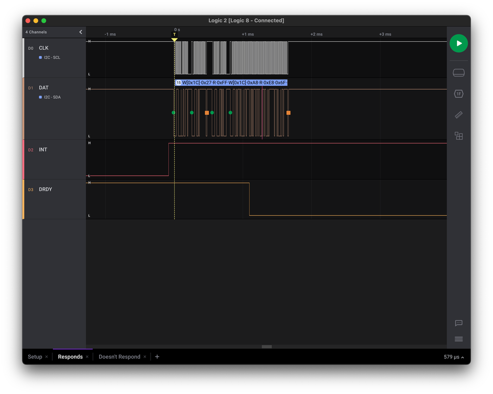

Then here's the read:
write to 0x1C ack data: 0x27
read to 0x1C ack data: 0xFF
write to 0x1C ack data: 0xA8
read to 0x1C ack data: 0xE8 0x6F 0x57 0xD8 0xD8 0x7F 0xE8 0x6F
If another interrupt happens after that, the device doesn't respond: (nothing happens in between)

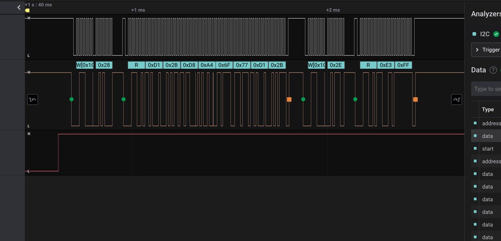

from the first picture it looks that the INT is latched. Did you configured it by purpose?
Note, from the datasheet p.29, that if you want to clear it you have to:
Once latched, the INT pin remains in the same state until INT_SRC (31h) is read.
So, in order to clear a latched interrupt you have to read the reg 31h after the interrupt has been raised.
-Eleon

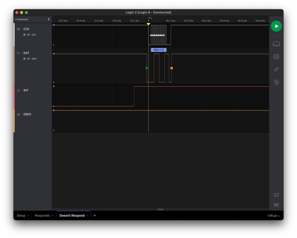

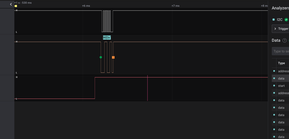

When it doesn't work, I get a successful interrupt on the INT pin but it doesn't respond (no ACK) over I2C.
For example, here are three events one right after each other. I'm able to read the first time, NACKs the second and then continues to work on the third:
0693W00000HpJumQAF.pngThe red trace is the interrupt signal. White is CLK. Orange is SDA.
