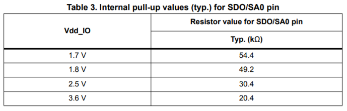

It might be related to the SDO/SA0 pin at hardware / firmware level?
Please note in fact that this pin has an internal pull-up, and if you are connecting it to the GND (for example, when your device is in idle state) you will experience the consumption coming from the pull-up resisters (see datasheet, p.9):
0693W00000DnNXDQA3.pngCan you please try to leave it at Vdd when the SPI is not running?
-Eleon
-Eleon
