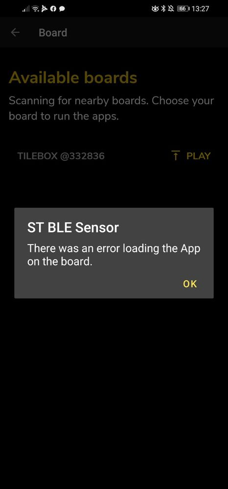

which application are you trying to upload on your SensorTile.box? An already-built one (Mode1) or a custom one (Mode2)?
I see that the, so you correctly paired the devices, right (using the 123456 code)?

Hi Eleon,
Basically I follow this pathway : Create an application - Vibration Monitor - Vibration Monitor compare.
And the first time SensorTile.box was connected to the mobile App i used 123456 code to pair it.

It might be related to the Vibration Monitor compare only. Are you facing the issue also while uploading other predefined apps?
The "Vibration Monitor compare" needs a csv file on the SD card, which is the reference for the vibration monitor comparison. You can create it in a first step, writing an acceleration pattern on the SD card, and then try again uploading the Vibration Monitor compare app.

Hi Eleon,
Well, I also tried to upload other predefined apps, but unfortunately this problem persists.

does the problem persist with all the predefined apps or only with some ones?

Hi @Eleon BORLINI
The problem persists with all predefined apps, can the problem be with Bluetooth protocol?

Hi @ATrif.1 ,
it might be... you might try to restore the Sensortile.box firmware to the factory one in the way described in this post (LINK), but not sure this can be the solution.
