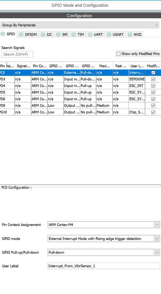

I am new to the lsm6dsv16x sensor and I would like to set it up to read the full fifo as an interrupt vs polling due to speed.
I am following the example from github setting up my gpio as an external event for interrupt int1.
But I am having an issue where the interrupt does not trigger unless I remove and put back the wire from the pin on the dev board. And only reads one or two times unless I remove the wire and put it back on the gpio. Any idea why this is happening?
I am not sure why this is happening. I checked the pin and it is low without the imu interrupt pin, and it stays high with the interrupt pin connected.
Not sure if I need pull ups or pull downs on the interrupt pin.
Also, Do I need to wake up the accelerometer when I need it? or can it stay on at all times?

Isn't the lsm6dsv16x interrupt active low? I haven't looked at the data sheet for the lsm6dsv16x so I don't know if it's a open collector output? If it is which is more than likely, you'll need a pull-up on the interrupt pin. But also you need to change the GPIO mode to falling edge.
2024-04-29 4:05 PM
So I looked at the datasheet of the sensor and the sensor is by default push pull.
PP_OD
Push-pull/open-drain selection on INT1 and INT2 pins. Default value: 0
(0: push-pull mode;
1: open-drain mode)
I set up according to @Karl Yamashita and still see the same issue.
