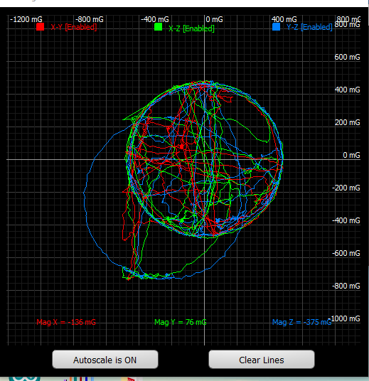

2020-02-12 5:18 AM
I noticed there was an error in the code. I used an accelerometer HAL function to normalize the raw magnetometer value to Gauss. However, the LIS2MDL is fixed at 1.5 mG per unit of measure. So instead I now divide by 1.5 to get mG:
// Convert raw magnetometer value to milligauss.
// Sensitivity of magnetometer for LIS2MDL is 1.5mgauss/LSB, sensitivity .
// magnetic_field_mgauss[0] = lsm6dso_from_fs4_to_mg(data_raw_magnetic_field.i16bit[0]);
// magnetic_field_mgauss[1] = lsm6dso_from_fs4_to_mg(data_raw_magnetic_field.i16bit[1]);
// magnetic_field_mgauss[2] = lsm6dso_from_fs4_to_mg(data_raw_magnetic_field.i16bit[2]);
magnetic_field_mgauss[0] = (data_raw_magnetic_field.i16bit[0] / 1.5);
magnetic_field_mgauss[1] = (data_raw_magnetic_field.i16bit[1] / 1.5);
magnetic_field_mgauss[2] = (data_raw_magnetic_field.i16bit[2] / 1.5);
...Unfortunately, this did not fix the problem.
2020-02-12 6:46 AM
You can use function lis2mdl_from_lsb_to_mgauss to convert raw data to mgauss.
This function multiply the value by 1.5 so I think your code is wrong.
float_t lis2mdl_from_lsb_to_mgauss(int16_t lsb)
return ((float_t)lsb * 1.5f);
2020-02-12 7:54 AM
Ah! That Worked!
...can't believe I wasn't able to get here empirically (print out the values and adjust them until they are all in an expected range).
-thanks!
