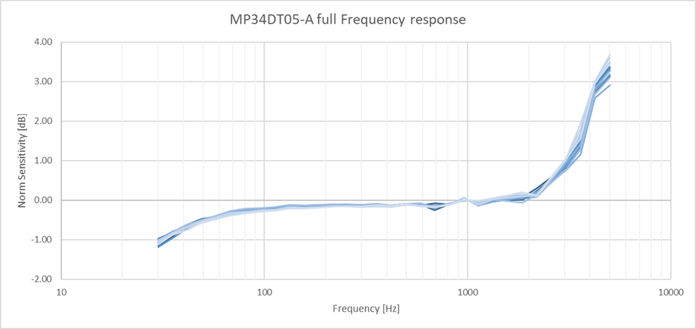

Hi @GKris.1 , the MP34DT05-A is suitable for 20Hz-20kHz band measures in the sense that there is no drop of sensitivity in that acoustic range. However, you have to pay attention to the eventual "gasket" in front of the sound port, especially for the high frequencies, because if not properly designed it can cause the Helmholtz resonance of the system to fall inside the acoustical band (as described in the AN4427; see also AN4426 p.15). I can share you a typ full 20Hz-20kHz frequency response here below:
