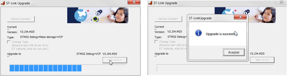

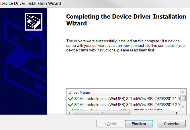

First, I install STSW-LINK007 and STSW-LINK009 as manual says.

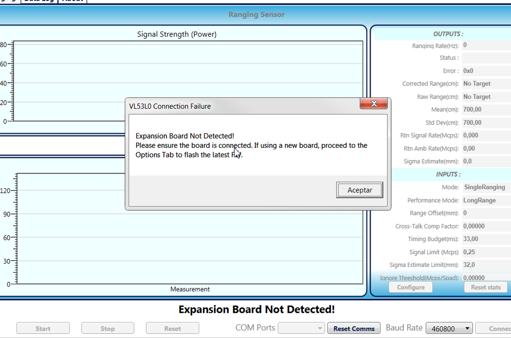

Then I connect X-NUCLEO-53L0A1 + NUCLEO-L476RG to my USB port, start the application and get the next error:
Why is this happening? Does VL53L0X GUI only works with NUCLEO-F401RE but not with NUCLEO-L476RG?

2020-05-12 7:13 AM
Unfortunately we have only written the GUI to support the STM32F401 Nucleo-64 board.
So nothing is broken and you did everything correctly, but you need a different MCU board.
Good news is that they are only about $10, and quite available from Mouser, Digikey or wherever you bought your original kit.
Sorry about that.
