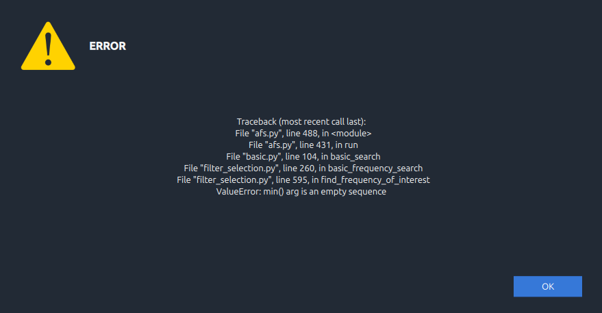

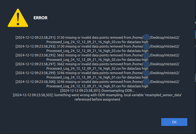

I watched a handful of webinars and read through tutorials related to the LSM6DSV16X's machine learning core. Most of these covered the basics, but only the basics (as in, they only show the most barebones demonstration with a single sample of a single simple movement). When attempting to generate a decision tree on my own using custom data, I ran into several problems.
First, I collected 4 samples of a basic jab motion and labeled the data "strike" and "retract" for each. Everything worked up to the point where I generated the decision tree and got a confidence value of 0%. Then, I attempted to simplify the data and only use one sample of one movement (just the strike component). At this point, I began to see the error below when running the AFS tool.

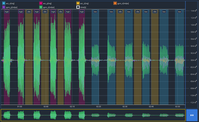

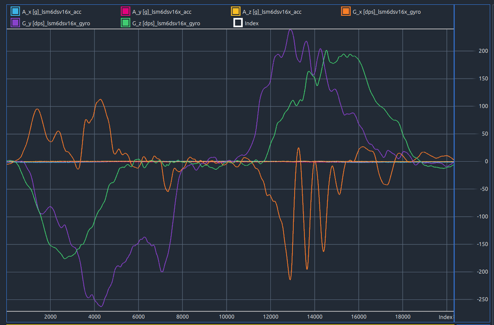

I collected new samples, this time a simpler and slower bicep curl movement:
Even with the new data, I continue seeing the same error when running the AFS tool. Is this a bug, or something I'm doing wrong? My goal is to eventually detect baseball swings and use the interrupt from the MLC as a trigger for storing high-frequency IMU data, but at the moment I'm not able to successfully produce a configuration for the MLC using simple movements.

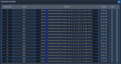

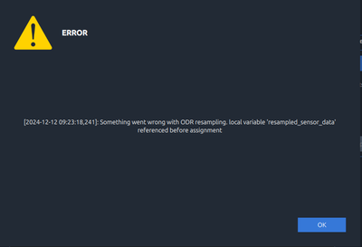

I tried again by setting explicit labels for the "up" and "down" motion of a bicep curl. When I add two samples of each, I get the error below:

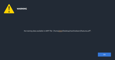

When I only add one sample of each, I successfully run the AFS, generate the ARFF file, and get an error on the decision tree generation step.
I wish more context would be provided when these errors are flagged. Script error tracebacks don't provide sufficient information about what exactly I'm doing to wrong in order to troubleshoot this independently. I also haven't found any online forum posts or documentation about these errors, so I'm assuming it's some sort of issue specifically related to my setup and/or data.

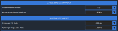

@Federica Bossi thank you for getting back to me. I attached a zip file containing the processed and unprocessed logs, along with the MLC config json for my most recent attempt this morning. I also outlined my process below.

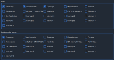

1. Connect STbox.Pro to MEMS Studio, set accelerometer and gyroscope range.
2. Only enable timestamp, accelerometer, and gyroscope in the Save to File tab for datalogging.
3. Label data using the Data Analysis tool.
4. Add the labeled data to the machine learning workspace, select LSM6DSV32X as the sensor.
5. Attempt to run the AFS tool.
I tried a variety of configurations on the AFS window between ML ODR, window length, selecting just accelerometer or just gyroscope, disabling certain outputs, removing samples, etc. but I always get one of these errors.
2024-12-17 8:46 AM
Hello @rbmarcus,
I have analyzed your project. Unfortunately there is an issue in MEMS Studio in saving the labeled data in Data Analysis tool. This caused data corruption and the logs cannot be process by the AFS tool.
A workaround could be split the unprocessed log in different tool or acquire the data for each class separately and don't use the Data Analysis to split the data.
We are planning to release new version of MEMS Studio with the bug fix this week.
I'm sorry for inconvenience.

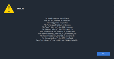

The problem is still present on 1.4.2. I get the "TypeError: Object of type int64 is not JSON serializable" warning with the attached data set. It looks like it's in a different region in code now compared to previously:
I tested this a while back with some simple data and everything seemed to be working, so I'm not sure if the problem is specific to larger data sets now or if I just got lucky previously. Data was obtained via Sensor Evaluation -> Save to File tab and parsed with Data Analysis. I can try a different way to split the data but these warning messages don't indicate to me what the exact problem is, since the processed data looks fine when comparing to the raw CSV.
