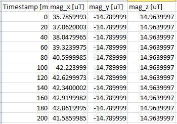

While trying to calibrate the magnetometer, upon successive failures, I noticed that the values that were read for the Y and Z axes are successively repeated until a different value is read (as can be seen below). It appears that there's some kind of great threshold for a new value to be stored in the register.
It's hard to debug this issue, especially since the documentation on the magnetometer of the LSM9DS1 is quite scarce (namely its functionality, as opposed to the accelerometer and gyroscope on the datasheet).

I have attached a .csv file that serves as a datalog of the several readings while rotating the LSM9DS1 with the motion described in section 2.2.5 of the UM2192.
Any idea on what might be causing this issue?

I'm having the same issue. My X values update normally, but Y and Z get stuck on initial values. In my case on the board I'm working with a high current inductor was placed an inch or so away along the IMU's positive Y axis. Only X works. I figured the interfering magnetic field lines were travelling along the Z and Y axes though mostly perpendicular to the X axis. My circumstances are rather specific and I doubt the odds of yours being the same. It would be helpful to know if this is actually a software issue.
