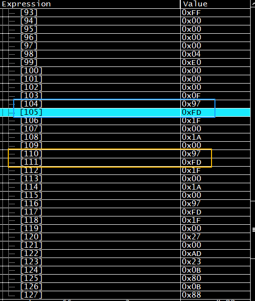

The measurement data of LIS2MDL was read in the application. Both the Y and Z axes were normal, and their data changed with the position. However, the data of the X axis was abnormal, and its value was the same as TEMP_OUT. Moreover, it was not related to the position. As shown in the screenshot below.
Chip settings: CFG_REG_A = 0X80
Dear friends, could you please help me figure out what the problem is?
Thank you!

Hi @MPME_240117 ,
Have you already used our official drivers to exclude issues related to your code?
You can find them on Github.
