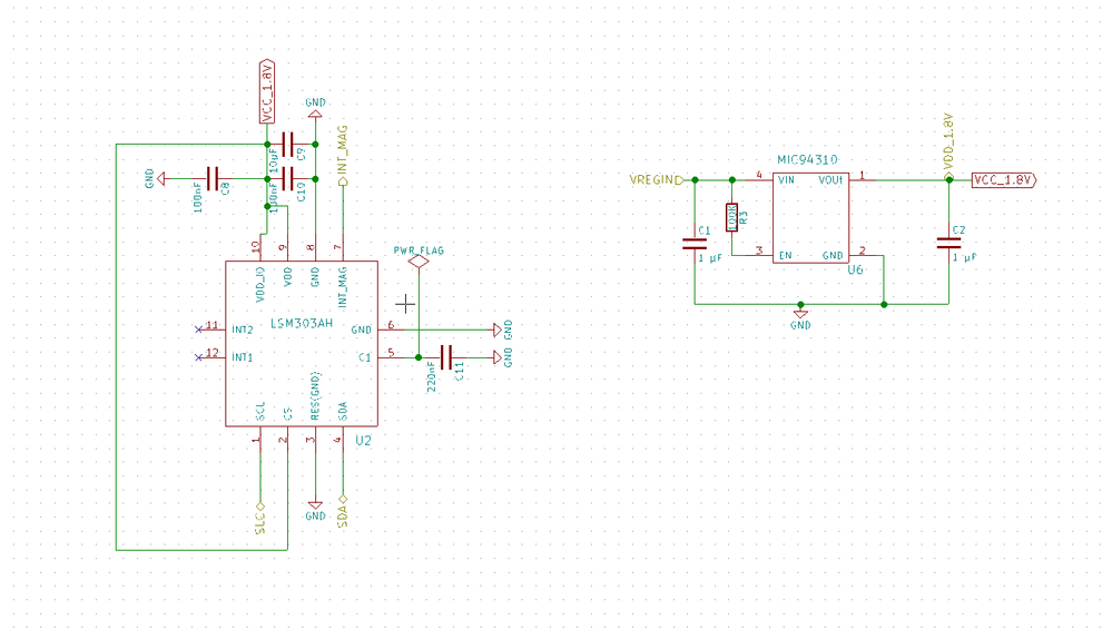

I have made the same mistakes on my customized PCB, supplied LSM303AH directly with 3.3 and this is does not work. I have remade the same schematic as recommended in the data sheet.

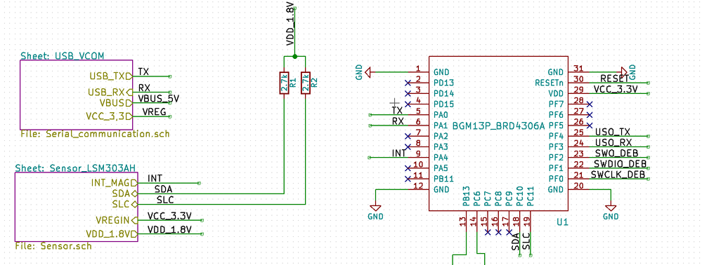

However, which is the VddIO value in your pcb? Are you communicating with the LSM303AH device via SPI (no pull-up needed) or I2C (pull-up neede at Vdd)? You should also check if yor master SPI / I2C works well when Vdd is 3.3V. Regards

My custom PCB made VDD and VDD_ID connected together supplied with 1.8 v throw regulator which transforme 3.3v to 1.8v.
But my MCU is working with 3.3 v, when i have seen the I2C communication not working i have made some adaptation to make VDD and VDD_IO supplied with 3.3 volt and still i have the same problem.
Yes i have made pull-up resistor fir SCL and SDA.
My I2C Master is working with 3.3 v.
Please find attached schematic.
