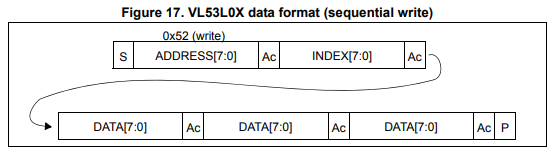

Hi @Singh.Harjit , the LSM6DSL or LSM6DSR sensor hub interface is intended to be used mostly in combination with pressure sensors and magnetometers or with other accelerometers / gyroscopes. They have a standard (for MEMS devices) 8-bit I2C device address and standard 8-bit register addresses. I'm not an expert on the proximity sensors, but VL53L1X, as you pointed our, has a 8-bit device address but a 16-bit register address. You may however try with the VL53L0X sensor, whose I2C communication is depicted in the datasheet and doesn't require 16-bit addresses:
The procedure for the sensor hub (Mode2, AN5358 p.73) can maybe be modified as below, but should be checked:
1. Write 40h to FUNC_CFG_ACCESS // Enable access to sensor hub registers
2. Write EXT_SENS_ADDR | 01h to SLV0_ADD // Configure external device address (EXT_SENS_ADDR)
// Enable read operation (rw_0 = 1)
3. Write REG to SLV0_SUBADD // Configure address (REG) of the register to be read
2b. Write EXT_SENS_ADDR | 01h to SLV0_ADD // Configure external device address (EXT_SENS_ADDR)
3b. Write REG to SLV0_SUBADD // Configure address (REG) of the register to be read
4. Write 0xh to SLAVE0_CONFIG // Read x bytes (up to six), SHUB_ODR = 104 Hz
5. Write 4Ch to MASTER_CONFIG // WRITE_ONCE is mandatory for read
// I²C master enabled, using slave 0 only
// I²C pull-ups enabled on SDx and SCx
6. Write 00h to FUNC_CFG_ACCESS // Disable access to sensor hub registersStay safe! Regards
