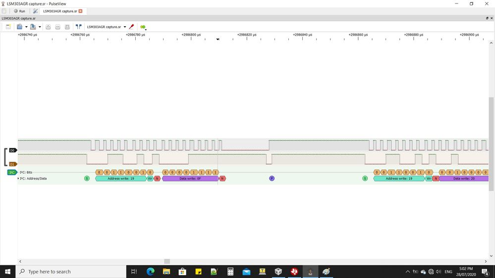

Here is the I2C Logic Analyzer to read the Device ID, From this we just write but no reply from the LSM303AGR. I am using TI CC2640R2F to communicate with LSM303AGR.

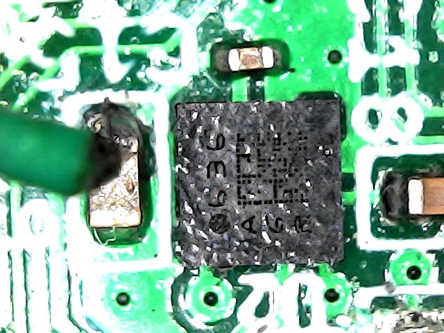

Here is the USB Microscope picture of the LSM303AGR. From the marking I am not entirely sure if it is LSM303AGR.

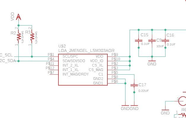

Here is the LSM303AGR circuitry which is according to the datasheet. The pull up resistors value is 5.1 KOhm
Using the I2C lines of this board, I communicated with I2C TMP007 of another board without problems, meaning there is no problem with the I2C lines. My troubleshooting investigation is pointing to that there is really a problem with the LSM303AGR or the I2C Slave Address is different.
