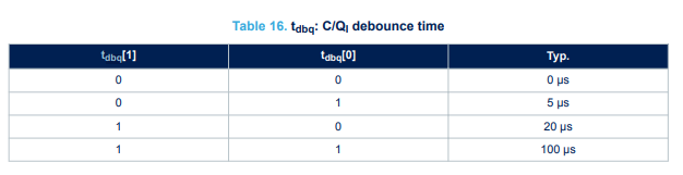

As regard the read error, if the master is set in receiver condition you should control the debounce time that you have selected depending on the baudrate, because if it is incorrect the L6360 will filter the incoming data frame.
You can run a test setting the debounce (tdbq bit) at Zero so that you don't have any filtering during the reception phase.
