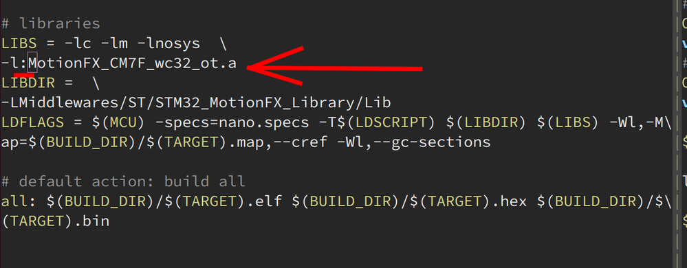

i'm a linux user, so i use cubeMX gen a code framework with project type: Makefiles
now, i try to use x-mems lib, the makefile is miss a ":" that lead "make" command error.
after add the colon, seems good

Hi @MMa.1893​ ,
just checked internally and you are right, there's a colon missing...
Thank you for the bug report!
