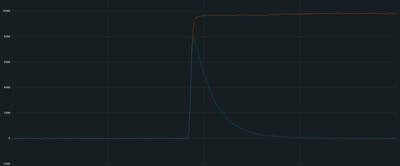

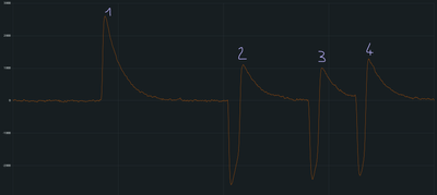

hi,
I have also saw that we can get negative value for Motion an Presence .
Lets talk about Presence value:
with Threshold=4000
1- if the Presence (Orange plot) is more than Threshold and object don't move in the FOV, Presence stay stable. this is Ok
2- if the Presence (Orange plot) is less than Threshold-hysteresis and object don't move in the FOV, Presence decrease slowly to 0.
     Why ?
   if the object is remove then placed at same position, Presence can not get the same value as before.
   The max Value 2,3,4 is always lower than before 1 (see below)
   Presence can not be anymore higher than the threshold and this until that Presence value go to 0 after a negative value.
so object can not be detected (presence value will be always below threshold)
   Why ?

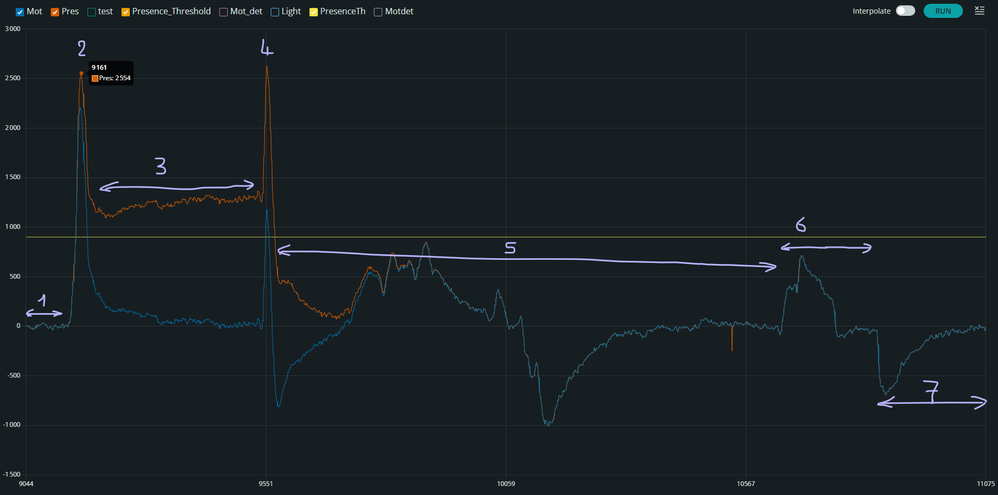

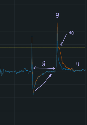

May be but if TPRESENCE is lower than PRESENCE_THS-Hyst, TPRESENCE decrease and decrease to reach 0 even if you are just below the sensor.
See below the plot simulation in office
1- Just reseting the sensor and I'm waiting (not in sensor area)
2- Enter in office below the sensor
3- Sat on my chair below the sensor
4- Get up below the sensor
its working well until !
5- I leave until the TPRESENCE is lower than PRESENCE_THS-Hyst
    And I go slowly the under the sensor without ever exceeding the threshold
6- I'm just under the sensor
7- I sit
After that I go outside sensor area
8- I wait that TPRESENCE reach 0
9- Enter below the sensor
10- sit , as you can see, the TPRESENCE gone below the Thresh
11- TPRESENCE decrease slowly to 0
So after that, it's impossible to set the light On.
So I'm waiting explanations and solution from ST @Federica Bossi @Joe WILLIAMS to solve or help about this problem.
