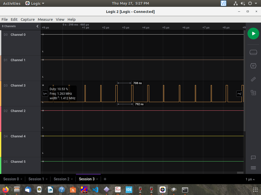

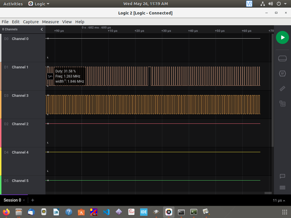

Below is the analyzer output for the sensor and sensor with PDM Clock:
Sensor Output:
Sensor with PDM Clock:
I have also tried testing at 2.4MHz, but just the frequency changes the output remains constant there as well.

Hi @NK.13omalan ,
are you only watching the signal with a digital analyzer?
maybe if you feed the pulse stream to a decoding library the signal is just what you expect.
there is a series of tutorial videos available online on microphone integration.
I would suggest to check out these.
Niccolò
