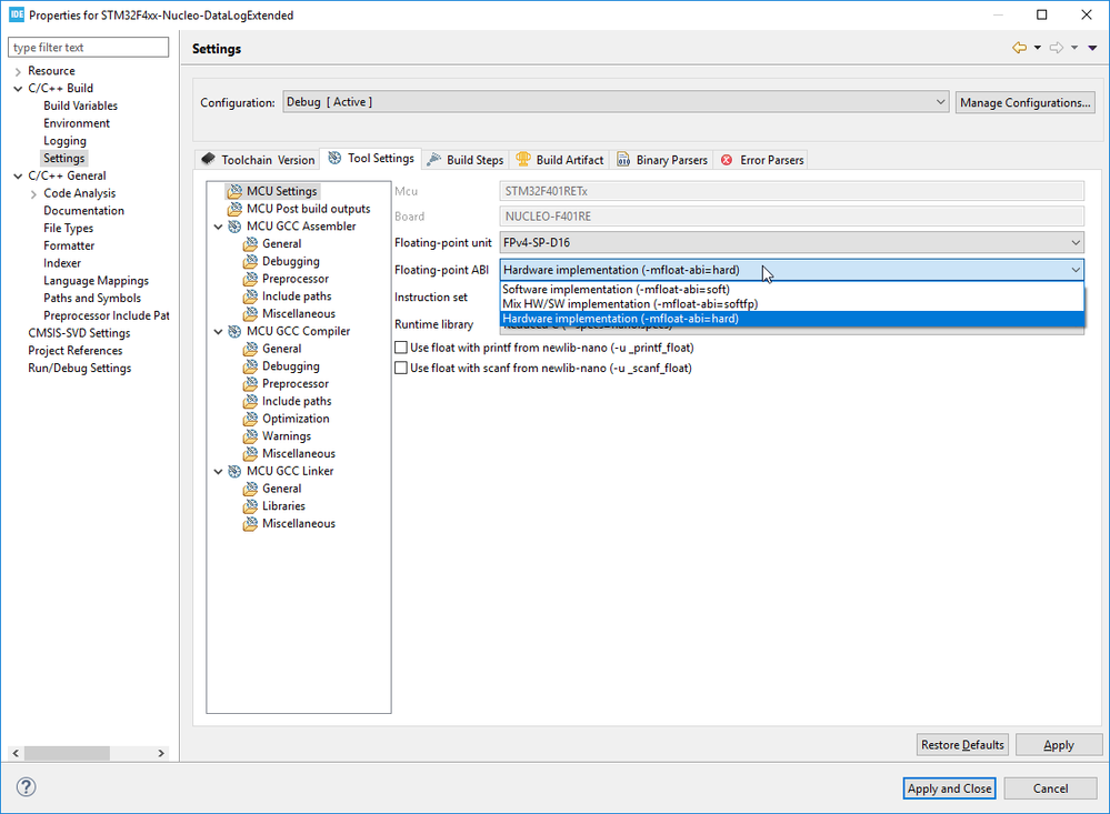

I'd like to use MotionFX library on STM32H7 together with FreeRTOS and STemWin Middlewares. I noticed that MotionFX has been compiled with -mfloat-abi=softfp, but others are prepared for -mfloat-abi=hard.
Could you please prepare "hard" ABI version of the library?
