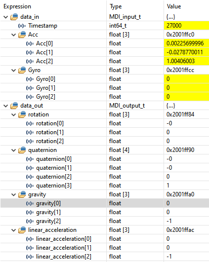

I'm trying to use the MotionDI library for a dynamic inclinometer application. My IMU is the LSM9DS1. The returned data from MotionDI_update() is shown below:
The values for rotation, quaternion, gravity, and linear acceleration never change, even when the IMU is moved. I initialized the MotionDI library according to the sample code in the documentation:

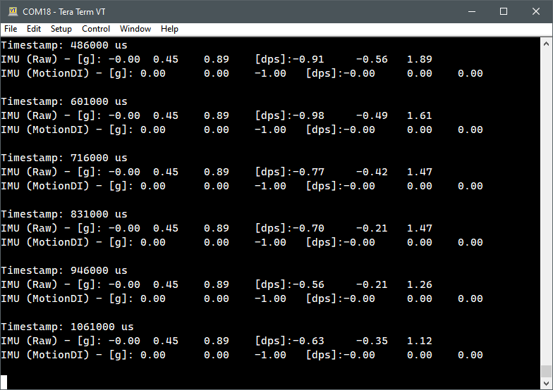

Hi Miroslav,
By datalog do you mean the output on the serial monitor? If so here it is, with the IMU tilted 45 degrees:

Thank you for the datalog, the data from accelerometer and gyroscope looks good, but your update data rate is low. I see the update data period is about 115ms.
Can you please update your code to increase the speed so the period is ideally 10ms.
