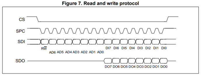

Please check if the SPI you are using on your board is the Mode 3 (CPOL = 1, CPHA = 1), and if it is different from the Discovery one (datasheet, p. 25):
-Eleon

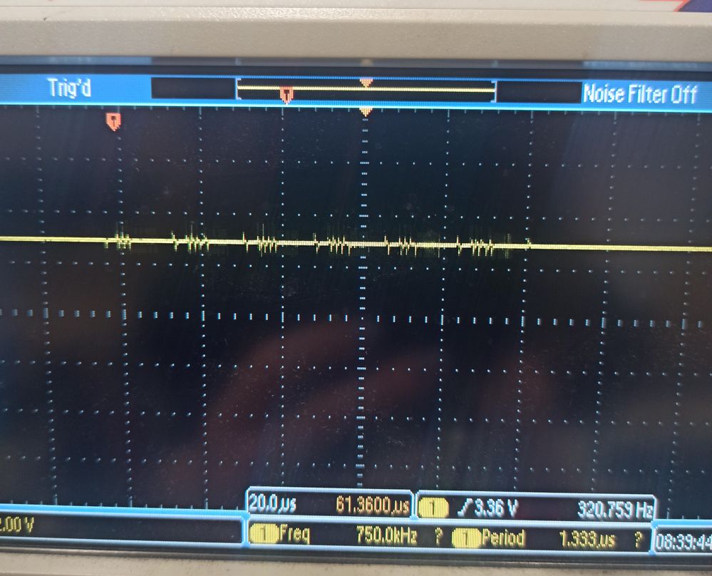

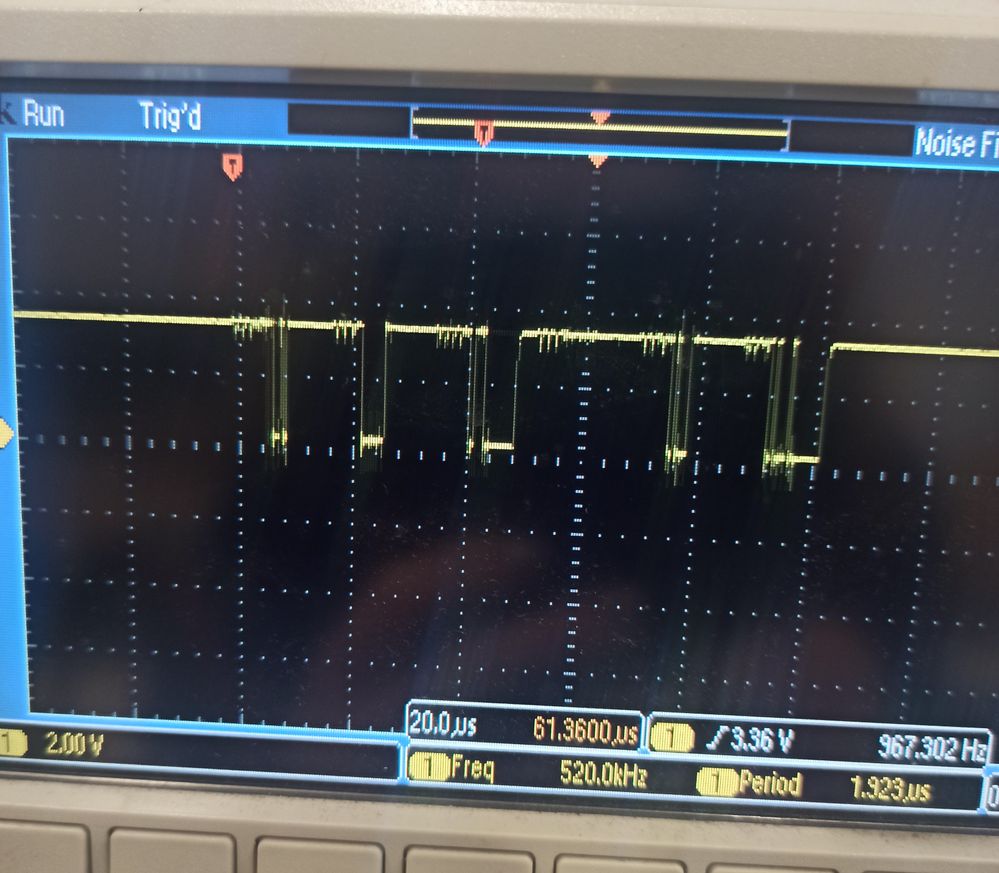

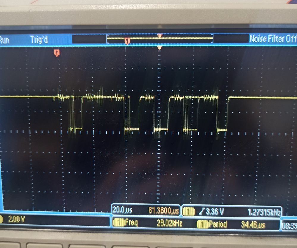

my SPI is in correct mode. I did some testing and i connected Discovery board with two additional LIS3DSH throughout SPI. I connected all the lines together, except MISO lines. Then on oscilloscope I looked at signals, and:
  • LIS3DSH on Discovery board is working great, I can see on oscilloscope that readings from registers OUTX, OUTY, OUTZ are "moving" which is correct.
  • LIS3DSH on one of my boards that worked before (but now stopped) is working great on X axis, Y axis isn't moving at all, always 0x8080, and Z axis looks like its readings are moved, because it often shows maximum range (2g) but when i move my board it changes to lower values (still, although readings are moving, it doesnt look correct)
  • LIS3DSH on another board, new one, always 0xFF, doesn't respond to anything.
0693W00000JOWUlQAP.jpgI also tried changing boards with LIS in places, but as I thought it didn't change a thing.
For now I don't have an idea what can cause this, I thought that maybe my board broke, and I need a special config for a new one, but if you say that there isn't such thing I have no clue.

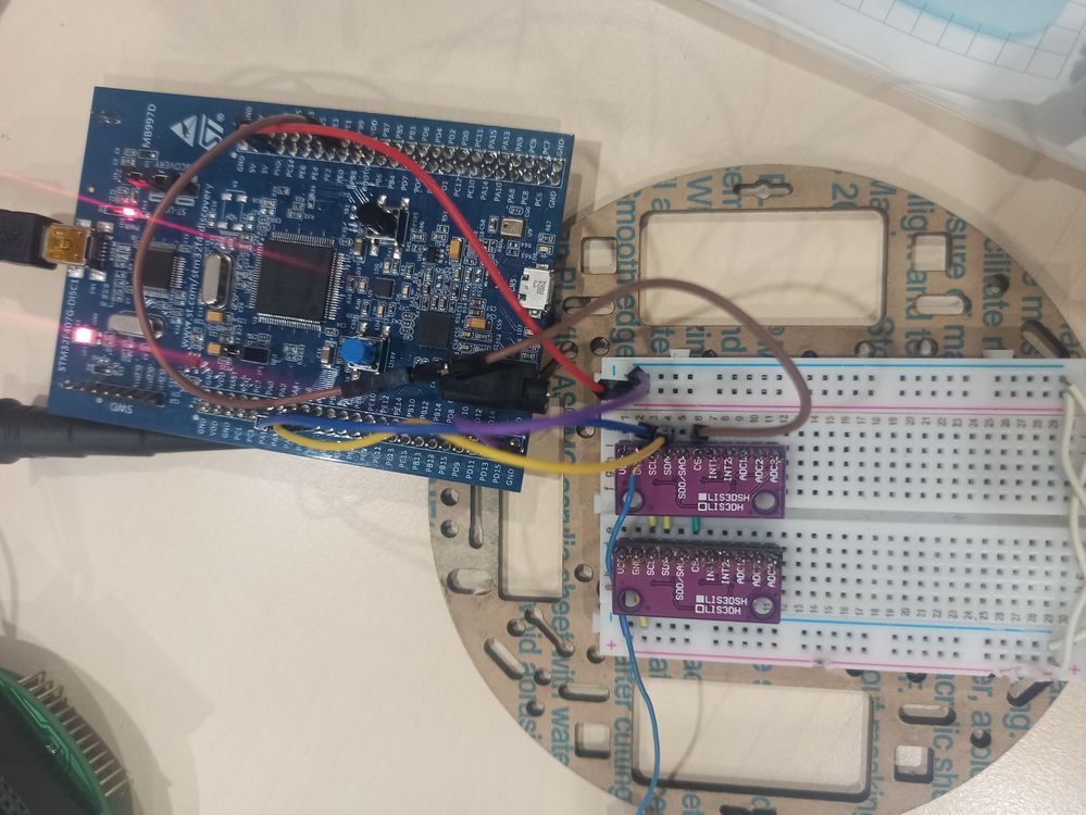

Here is a photo of my test circuit.
0693W00000JOWSfQAP.jpgThank your very much that you are trying to help me! :)
Hi @Maria Bąk​ ,
I know this is a dummy suggestion, but did you check the cables and connections are OK? I mean, you can check if the MOSI is stable before and after the cables, and check if the issue on the MISO can be related to this.
-Eleon
