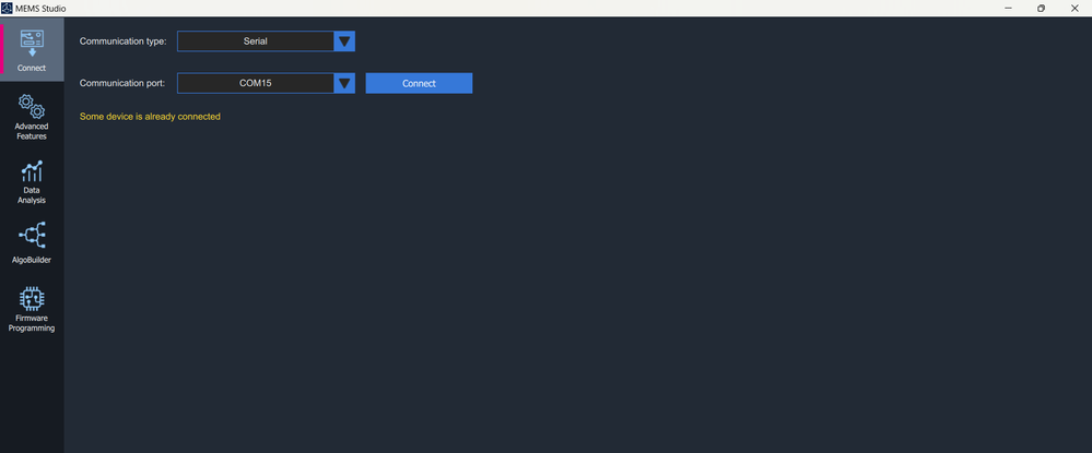

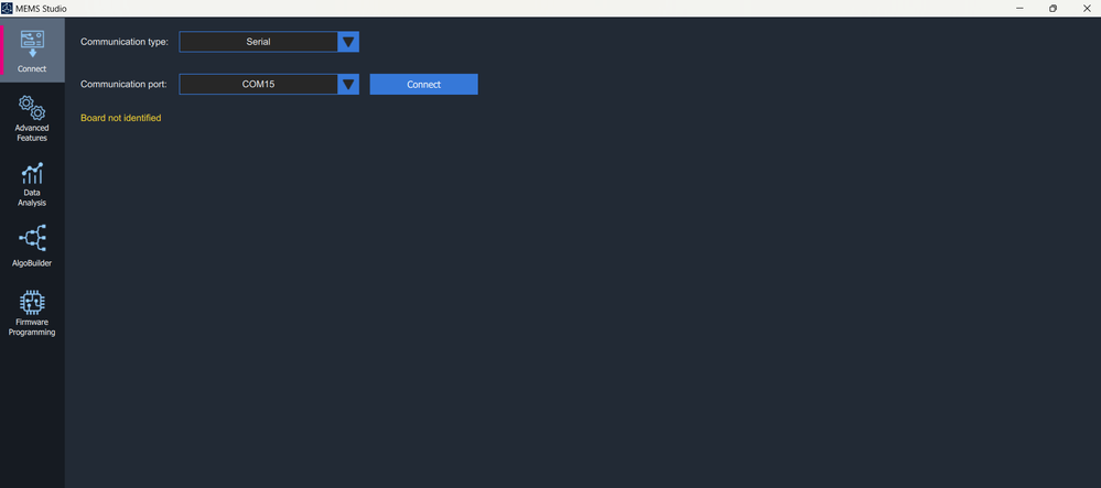

I have an X-NUCLEO-IKS4A1 mounted on top of a NUCLEO-L476RG and I am trying to connect that to Mems Studio. I get one of the two errors in the attached screenshots. Either "Board not identified" or "Some device is already connected".

Hello @tarunprasadoff
The NUCLEO (STM32) must be programmed with compatible firmware with MEMS Studio.
You can check chapter 2.6 Hardware and firmware compatibility in UM3233.
NUCLEO-L476RG + X-NUCLEO-IKS4A1 can be used in AlgoBuilder in MEMS Studio.
Sensor evaluation firmware (DatalogExtended) is unfortunately not available for NUCLEO-L476RG, please check X-CUBE-MEMS1 package.

2024-07-15 5:55 AM
Hello @Apollo1
the MEMS Studio opens the serial port and send "CMD_Read_PresString" command to read presentation string. This string describes the firmware and MEMS Studio can adjust the GUI according to the connected firmware.
The firmware from X-CUBE-MEMS1 will not work properly without appropriate X-NUCLEO board connected so it will not able able to respond to the "CMD_Read_PresString" command and the connection will not be establisted.

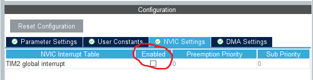

I don’t have the NUCLEO-G491RE available at the moment, but I did a quick check of your STM32CubeMX project. I noticed one issue - the interrupt from TIM2 is not enabled.
Please enable this interrupt and try again with MEMS Studio. I believe you should see the sensor data coming from the firmware. If not, please let me know, and I will try to get the NUCLEO board to debug the issue.

I can confirm enabling the interrupt for TIM2 fixes the issue with MEMS-Studio regarding to data acquisition with the NUCLEO-G491RE board.
