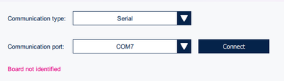

After programming I tried to connect to the board. A COM port is displayed but trying to connect leads to "Board not identified".

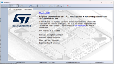

but still the same problem : Unicleo don't see any board neither showing any graph :

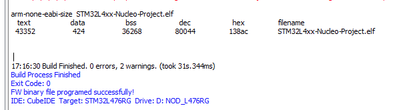

I just want to mention that while building firmware, got an error in bytecpy function :
Error: In function 'bytecpy',
Error: inlined from 'lsm6dso_mode_set' at C:/Test/Drivers/BSP/Components/lsm6dso/lsm6dso_reg.c:12217:5:
Error: C:/Test/Drivers/BSP/Components/lsm6dso/lsm6dso_reg.c:97:13: warning: '*(uint8_t *)(&ctrl2_ois + offsetof(lsm6dso_ctrl2_ois_t, hp_en_ois))' may be used uninitialized [-Wmaybe-uninitialized]
Error: 97 | *target = *source;
Error: | ~~~~~~~~^~~~~~~~~
Error: C:/Test/Drivers/BSP/Components/lsm6dso/lsm6dso_reg.c: In function 'lsm6dso_mode_set':
Error: C:/Test/Drivers/BSP/Components/lsm6dso/lsm6dso_reg.c:11787:23: note: '*(uint8_t *)(&ctrl2_ois + offsetof(lsm6dso_ctrl2_ois_t, hp_en_ois))' was declared here
Error: 11787 | lsm6dso_ctrl2_ois_t ctrl2_ois;
Error: | ^~~~~~~~~
But the tool is still able to build the project :
Any other idea ?

Building is successfull and programming also.
But I'm still unable to connect the board :

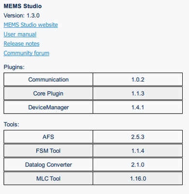

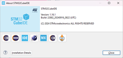

All tools seems up to date :

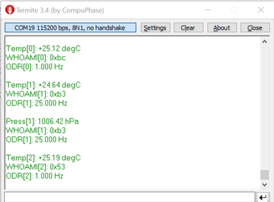

Could you please test if the boards are all right using the provided binary file "datalogterminalNUCLEO-L476RG.bin"?
After uploading this binary to the Nucleo, if the boards are okay, you should be able to see the output of the extension board sensors in a terminal as shown in the provided screenshot.
Let us know the result.
