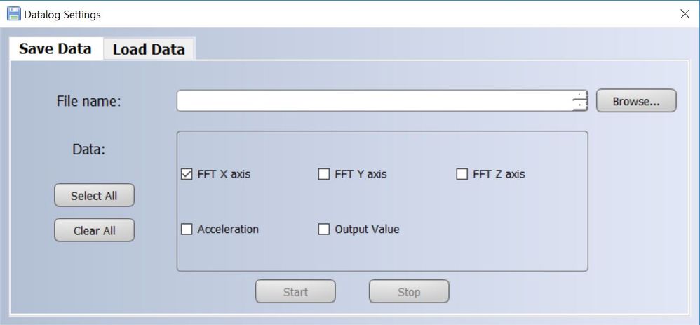

I have a Nucleo board and use the FFT example that comes with Algobuilder. It shows all the data and the results from FFT in the separate window. I would like to export all the data (accelerometer values, FFT results, peaks, etc). It works with accelerometer data and "single values" like peaks. But not with the actual FFT results.
In the "Datalog" tab I can select the different output values, also FFT X/Y/Z axis, but this has no impact on the generated file.

unfortunately it is no possible to continuously store the FFT data. The only way is to press the Save button in FFT window.
