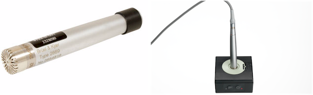

Thanks Eleon, that makes sense. The application is industrial and runs on 24V DC so no power issues. I am liking the digital microphones for their ease of use and dynamic range. Would be nice to have them packaged in a conventional 1/2" cartridge* so a 94dB acoustic calibrator could be supplied to verify the measurement chain back to the DCS (will be adding a 4-20mA output). I may have to get an engineered housing to accommodate the MEMS microphone. Only need acoustic frequencies so 20Hz to 10kHz is perfectly adequate and the ~30dB Noise Floor is not a problem as the equipment being monitored operates around 95dB(A)0690X000006DOIaQAO.png * example of conventional 1/2 inch condenser microphone pre-amp and 94dB (1Pa @ 1kHz) acoustic calibrator
