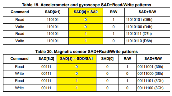

Concerning the table 19. Column SA0 - yellow.
LSB for accelerometer or gyroscope.
Values '0' and '1' in which cases ?
Whether does mean that i must correspondingly set input pin 5 (SD0_/AG)
Thanks in advance
Dmitrij

If you have two sensors on the same I2C bus you have to distinguish them by different SD0_/AG connection thus different I2C address.
Posted on October 24, 2017 at 12:24
I'm not sure if I understand you question. The Table 19 describes the I2C address for accelerometer and gyroscope, both sensors have the same address. If the pin is connected to GND the SAD[0] bit is 0, if the pin is connected to VDD_IO the SAD[0] bit is 1.

What is the difference between 1-st and 3-rd rows in the table or between 2-nd and 4-th ?
It seems to me that the column “R/W� and correspondingly signal “read-write� together with device address SAD[6:1] uniquely define the operation. So, what is the sense of SA0?
Whether does mean that simply it is indifferent “0� or “1� on SA0 ?
