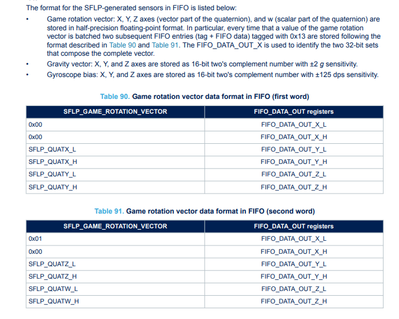

- for game rotation vector, I got two consequtive entries having TAG=19 in FIFO everytime, at the same timing. Those two entries have completely different values. With the application note and the post in this forum, I understand the FIFO entry for game rotation vector hold only x, y, z elements and w needs to be calculated at the host side. For example (the order is, w - which I calculate, x, y, z):
LSM6DSV80X_SFLP_GAME_ROTATION_VECTOR_TAG game_rotation_mg: 0.81 0.00 -0.09 -0.32
LSM6DSV80X_SFLP_GAME_ROTATION_VECTOR_TAG game_rotation_mg: 0.24 0.00 0.31 0.89
How can I interpret these values?

-As for the Timestamp doubt, it represents the timestamp of the right after FIFO DATA.
-As for the game rotation vector, please refer to the AN6281 paragraph 8.6.3, in order to better understand the content of each FIFO register for both the TAG_SENSOR = 0x13. The first represents the first word in Table 90, and the second TAG 0x13 represents the secondo word in Table 91
