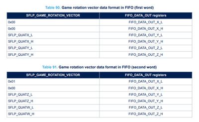

lsm6dsv80x_fifo_out_raw_get(&dev_ctx, &f_data);
if (f_data.tag == LSM6DSV80X_SFLP_GAME_ROTATION_VECTOR_TAG) {
  uint16_t hx = (f_data.data[1]<<8) | f_data.data[0];
  uint16_t hy = (f_data.data[3]<<8) | f_data.data[2];
  uint16_t hz = (f_data.data[5]<<8) | f_data.data[4];
  float x = npy_half_to_float(hx);
  float y = npy_half_to_float(hy);
  float z = npy_half_to_float(hz);
  Serial.printf("FIFO FLOATS : x=%.4f y=%.4f z=%.4f\n", x, y, z);

FIFO FLOATS : x=0.0000 y=-0.1245 z=-0.9414
RAW  FLOATS : w=0.2949 x=-0.1245 y=-0.9414 z=-0.0973

Hi @AhilanAshwin,
Did you try to have a look at the AN6281 and follow the information in section 8.6.3?
You should fine the game rotation data format stored in FIFO. Hope this could help you to solve your issue.
