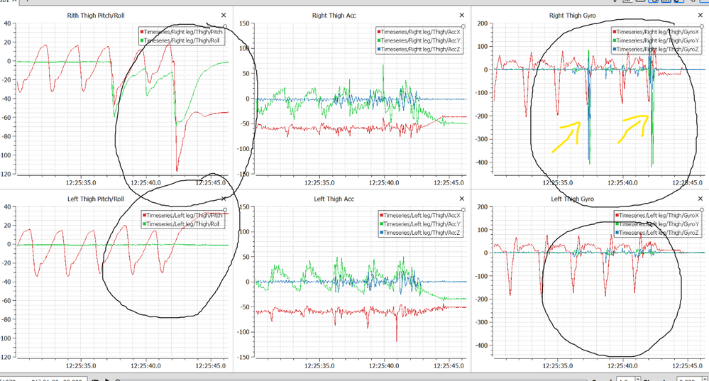

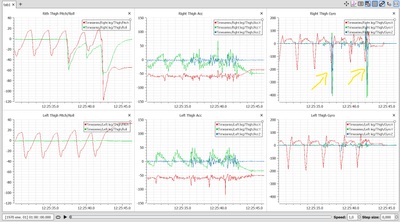

I am posting the last results we got from a test we did comparing two units of the LSM6DSV16X IMU.
Note that the IMU measurements are done simultaneously on both IMUs.
From the data, it is clear that the gyro sensor mounted on the right side is not working properly, as it shows sudden spikes of 400 deg/s.
@Smithson If this spike were to come from an external source, we would see these spikes on both IMU sensors.
It is annoying that the embedded self-test feature is not able to detect that this IMU unit is not working properly :(

My suggestion is to put the four circled signal in CSV format and upload them here.  Your issue does not appear Random, but I am only a pure mathematician who was led astray by the lure of money.
