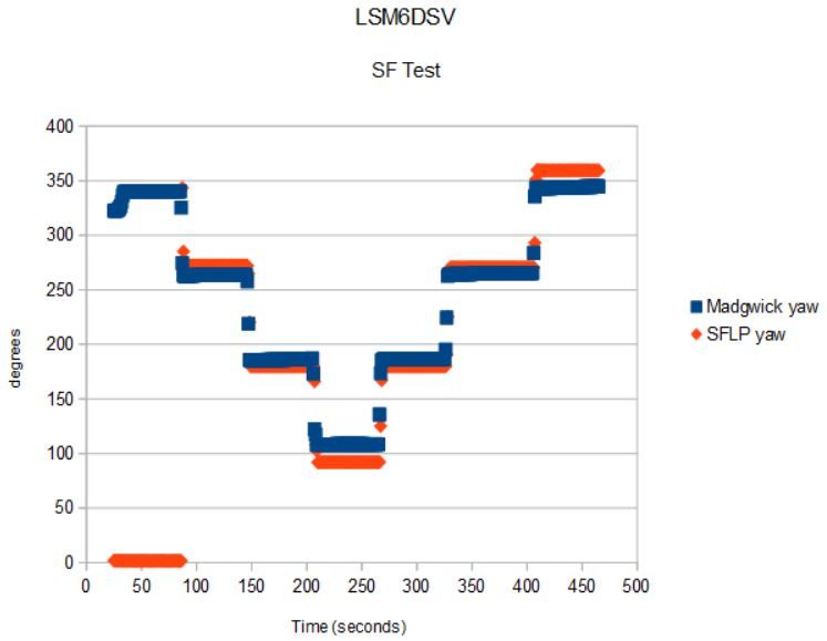

Just some additional information. After making sure the sum of the quaternion squares is always 1 or less I do not see any more NaN values. I compared the SFLP results with an simple open-source (Madgwick) sensor fusion algorithm. The LSM6DSV data provide essentially jitter-free results for both but the SFLP results are more accurate, properly showing 90-degree turns when rotating the breadboard by 90-degrees on the table top. I'd say the SFLP results are more accurate than I can hold the breadboard to the table edge. The Madgwick results are consistently low by about 10%; that is, they show turn angles of ~80 degrees for each turn. This could be cured with a fudge factor but there is no need to make use of the Madgwick algorithm on the MCU when the SFLP works so well...table-edge 90 turn testtable-edge 90 turn test
