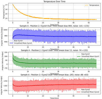

I took two attemps and recorded measurements in steady state (2 and 3 hours) that i want share.
Config:
G/XL FS: default
ODR 104Hz
Sensor data polled at rate ~ 90Hz
Some standby/wakeup stuff:
TAP_CFG0 (56h) = b0101.0001
2025-01-29 1:42 AM
Hi @ruig25 ,
It is a very little drift but looking at your data you can see a correlation with the temperature varying by 4 °C, when the temperature settles even the sensor outputs do not drift.
I recommend that you try to keep the temperature constant.
2025-01-29 3:20 AM - edited 2025-01-29 3:21 AM
I think I will try to write polynmial function for bias drift and mems temp as parameter using real measurements because the device supposed to be used from ~+10°C to +40°C.
In the datasheet zero-g +10 mdps per +1K. And vice versa i suppose: -10 mdps per -1K.
and sensitivitiy +0,007% or -0,007% (not 0,7%?) per +1K
Last measurements.
Earth gravity vector also affects stedy state measurements. Bias drifts about 10 mdps depending on sensor position.
