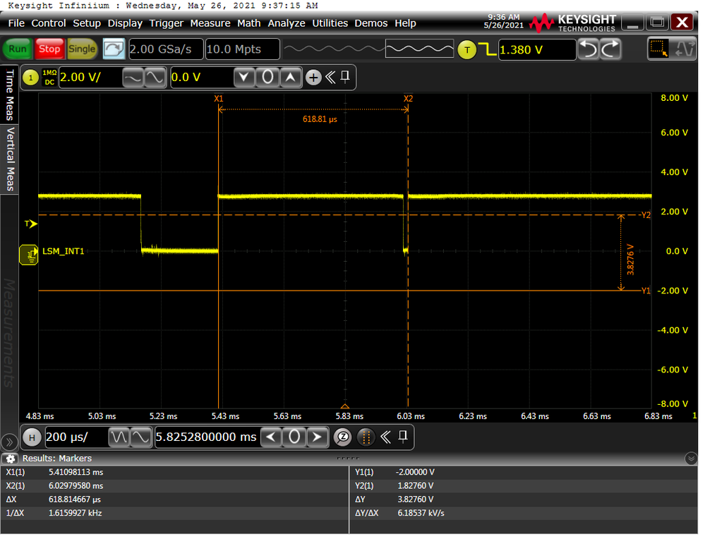

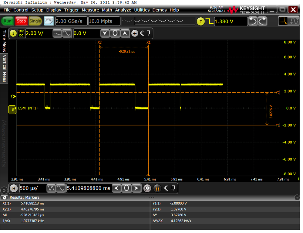

But int1 pin is measured as 1kHz or 1.6kHz
0693W00000APnfXQAT.png0693W00000APnfSQAT.pngHow could Int1 Pin change Low to High every 3333Hz?

Hi @Community member​ ,
it seems that the interrupt is not configured right.
can you check the status of bit INT1_DRDY_XL in register INT1_CTRL (0Dh)?
also, is your interrupt latched or not?
(check bit LIR in register TAP_CFG0 (56h))
