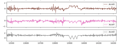

Hi!
I inherited a project and we're seeing strange accelerometer values and I'd like to get a sanity check on my configuration. when Idle and flat, I see 1g on Z, 0g on X and Y. When my device is moving I see peaks on many axes beyond 1g, eg 2.5 on X or Z, and it does not seem real. Here is downsampled data from a log file. X (brown) goes from +1.5g to -1.5g, Z (gray) is over 2.3g. I am not expecting such numbers during a short banked turn at ~15 mph

Thanks Federica. Bench testing always looks good. I get about 1G magnitude between the 3 axes. Even motion FX shows good rotation data on the bench.
Field data is always where we see the weird values. Our logging is only at 4Hz due to space constrictions.
